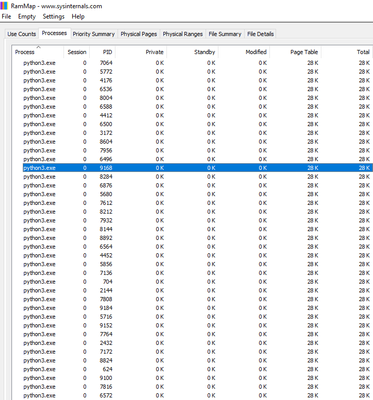

With the MS sysinternals tool rammap.exe we found a lot "zombie" processes (PIDs no more listed in task manager) which are still using some KB of memory (~20-32 KB). Process names are btool.exe, python3.exe, splunk-optimiz, splunkd.exe. It seems every time a process of one of these programs ends, it leaves behind such a memory usage. The Splunk apps on our Windows server do this very often and fast which results in thousands of zombie processes.

How to reproduce:
- OS tested: Windows Server 2016, 2019, 2022, Windows 10 22H2
- Splunk Enterprise Versions tested: 9.0.9, 9.1.3, 9.2.2 (Universal Forwarder not tested)
- let the default installation run for some hours (splunk service running)
- download rammap.exe from https://learn.microsoft.com/en-us/sysinternals/downloads/rammap and start it
- goto Processes tab, sort by Process column
- look for btool.exe, python3.exe and splunkd.exe with a small total memory usage of about ~ 20-32 KB. PIDs of this processes don't exists in task list (see Task manager or tasklist.exe)
- with the Splunk default installation (without any other apps) the memory usage slowly increases because the default apps script running interval isn't very high
- stopping Splunk service releases memory usage (and zombie processes disappear in rammap.exe)
- for faster results you can add an app for exessive testing with python3.exe, starting it in short (0 seconds) intervals. The test.py doesn't need to be exist! Splunk starts python3.exe anyway. Only inputs.conf file is needed:
