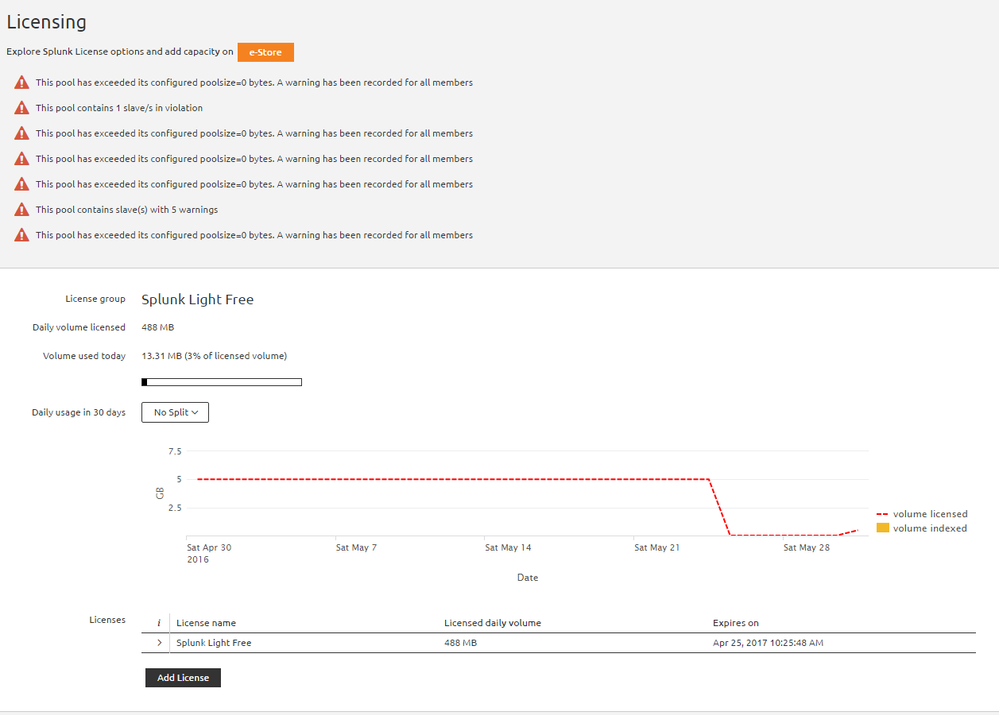

I was using SplunkLight in trial mode and the license expired.
I'm only collecting syslog from a few small devices well under <100MB/day. So we're talking a very small environment here.
I received a message upon logon that the license expired. I clicked a message to convert to free mode, and now I seem to be locked out of any searches because of license violations.
I don't understand the license violation because the free version has 500MB/day - and I'm a fraction of that.
Here's a screenshot of the licensing page. How do I fix this? Thanks in advance.

The root problem here was that Splunk Light Trial does not automatically turn into Splunk Free.
So when the trial on Splunk Light ends, it basically goes into non-compliance and locks itself out. So it is an overage - but the limit is 0 - so after any data comes in - lockdown mode.
The only way to fix this is to wait 30 days (I think it's that long) - or contact support and get a reset-license-violation license key. They provided this to me.
Then I had to run this at the command line to get Splunk into free mode:
(for Windows I had to first CD to C:\Program Files\Splunk\bin)
splunk edit licenser-groups Lite_Free -is_active 1
Not a straightforward process - but they were nice enough to help me get the free version running. You would think there would a a button on the license page to simply fix this. But since it's free I won't complain! I appreciate having this powerful tool for free.
