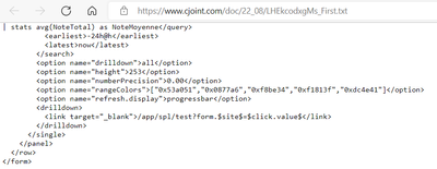

Here is the XML of the first dash
And the XML of the second dash
As you can see in the first dash, I want to retrieve the value selected from the dropdown list (line 97) and to drilldown this value in another dashboard (line 157)

I have a dropdown list with a token called "site"
when I a doing  choice in this dropdown list, I try a way to drilldown the events in my second dashboard with the value selected in the dropdown list
thats the reason why in the example I sent to you, site is between $...$
  <link target="_blank">/app/spl/test?form.$site$=$click.value$</link>
while in your example site is not between $....$
  <link target="_blank">/app/spl/test?form.site=$click.value$</link>
