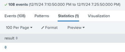

I have also tried with eval to output a result like this
index="my-index" | search "http 404" | stats count | eval result=if(count>=250 AND count<=500, 1, 0) | table result
which properly returns 1 or 0 depending on if the number of results are in the range I am looking for, however it is still not alerting properly when the trigger is set to >1.  I think the trigger is still running against the number of events which is also being returned (and I like that I can see this) and not the result I set up.
Screenshot 2024-12-11 at 2.30.54 PM.png.
Any other suggestions would be much appreciated.
richgalloway
@jwv wrote:
I've tried this a few ways with no success, I tried to just append the where condition on the end of my query so it looks something like this
index="my-index" | search "http 404" | stats count | where count => 250 AND count <= 100
but this still just returns the number of matching events and I run into the same problem trying to set up the alert.
That the search "just returns the number of matching events" is to be expected since that is all it is told to do.  The where command should cause the search to return a result only if that result is a number between 250 and 500; otherwise it should say "No results found".  That is what will trigger the alert - if there is a result (Number of events > 0) it's because the search criteria were met.
