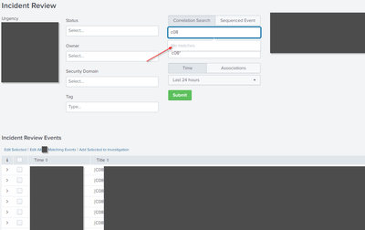

Hi folks,
A user in my company discovered that the pre-built list of Correlation-Searches in the filter on the Incident Review dashboard is incomplete.
I can well retreive the correlation searches in Content view and in Alerts views, and they have triggeresd notables.
I tried to find out the search ran to populated it but my skill in html/js are not enough.
Any idea ?

Hi,
It appears that the problem disappeared by itself after the upgrade of Enterprise Security from 6.4.0 to 6.6.2.

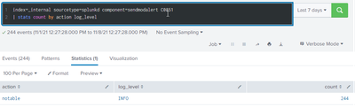

I walked through the article you suggested without seeing any issue:
- scheduled search results
- Events are well in notable (also checked for removal action but none)
- Checked the alerts generation:
- Checked the output : simple multiple fields, no xml or any other huge field's values.
- And more globally, nothing but INFO level in _internal
I find out that 2 correlation searches had a double-quote in a variable in action.notable.param.rule_description (e.g. $"variable$) but it has particular no effect on the parsing, as it didn't solve the problem.
Checking two searches, one working , one not, I didn't notice any noticable difference in the naming, special caracters or configuration options..
The working example has no drilldown, but found others working with it and without particular differenceon this.
At this point, it would be very helpful to know the search executed to populate the dropdown list...
