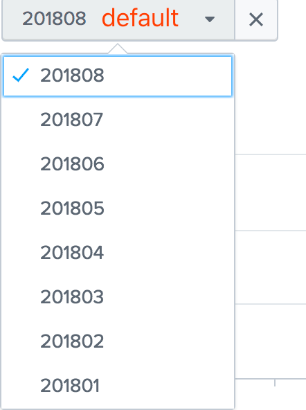

When the page is loaded, the drop-down box displays the last month of the month by default.
Now, if it's August, the drop-down box will display 201807 by default.
Now, if it's September, the drop-down box will display 201808 by default, and so on.

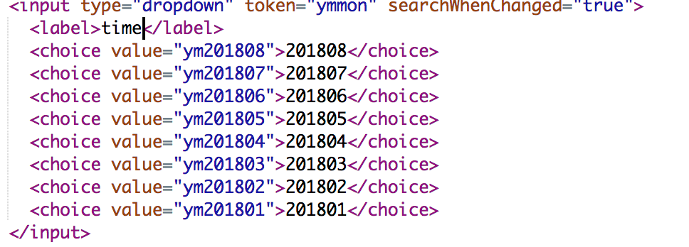

code xml
