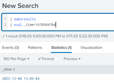

I have forwarded this log file to Splunk using the Splunk Forwarder. This script appends new log entries to the file after successfully completing each loop. However, I am not seeing the logs with the correct timestamps, as shown in the attached screenshot. The logs are from 2022, but I started sending them to Splunk on 17/01/2025. Additionally, the Splunk Forwarder is sending some logs as single-line events and others as multi-line events. Could you explain why this is happening?

Splunk recognize your account id as a timestamp. When you are taking it as epoch number and convert it to human readable those are matching.
ITWhisperer
Splunk is trying find a timestamp in your events - unfortunately your account id look like the internal representation of a date time i.e. number of seconds since 1st Jan 1970, so Splunk assigns the timestamp accordingly

Since you are generating these events with a script, modify the script to include a real timestamp at the beginning of the event (and if necessary configure the sourcetype to extract it)
