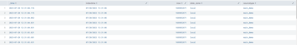

For some reason data from the mentioned sourcetype is delayed by 1 hour. I mean, I have to increase seachrtime to >60m to see the latest data. Below is the output of a query to compare index time and _time.

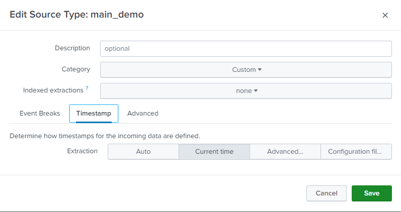

I tried to change timestamp extraction is sourcetype configuration in the cloud, but it didn't help.

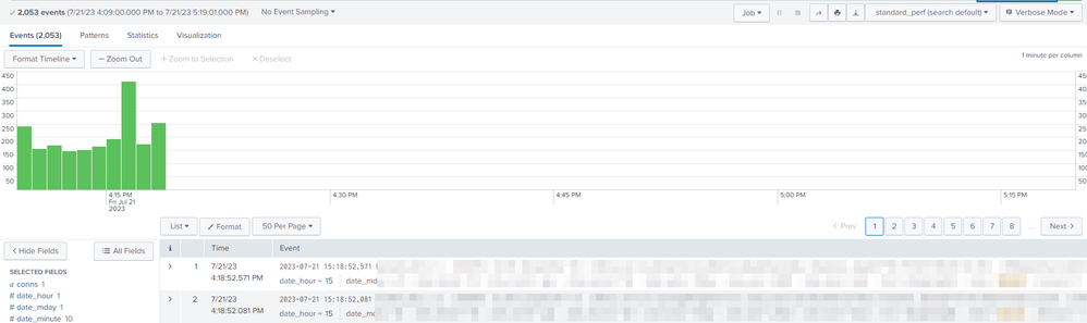

 And below is how logs are being visible in GUI
isoutamo
For some unknown reason your application is not aware of correct time! Have you restarted it after summer time has started? Time by time I have seen some apps which cannot do this automatically without restart. Anyhow you should report this to your app responsible and ask fix for this app.
slipinski
Do you mean "search and reporting" app? The only thing I can do is the restart Splunk cloud instance. Is it right?
isoutamo
No, I mean the source app where you are collecting logs. Based your screenshots time was wrongly in your log file.
slipinski
My app always uses UTC to put a timestamp. However, I always managed to use index time to display events correctly (ignoring app timestamp), but not in this case. As I said before, the logs are being displayed correctly from my lab system (the same app, the same timestamp set).  Weird.
