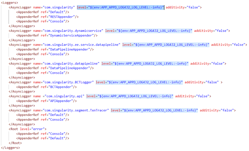

Felipe_Windmoll
Here on StackOverFlow  I share a script to change log4j2.xml and proxy.py automatically.
Besides the script, I put a tip on how to do this inside a Dockerfile.
Basically, I replace the hardcoded values on log4j2.xml and proxy.py by environment variables that allow you to change them more easily on deploy.
log4j2.xml with environment variable
proxy.py with environment variable
