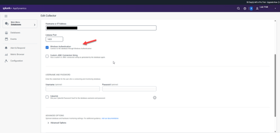

Hello appd experts,
I've installed a db agent collector using windows authentication as per image below to connect to MS SQL Server.
When starting the dbagent collector facing the issue below:
18 Mar 2025 14:02:14,194 ERROR [DBAgent-4] ADBMonitorConfigResolver: - [SQL_MES_TEST] Failed to resolve DB topological structure.
com.microsoft.sqlserver.jdbc.SQLServerException: This driver is not configured for integrated authentication. ClientConnectionId:84b24ba8-aae7-4084-a050-0de9e2f2ffea

Caused by: java.lang.UnsatisfiedLinkError: no mssql-jdbc_auth-8.4.0.x64 in java.library.path: C:\dbagent\db-agent-25.1.0.4748\auth\x64
        at java.lang.ClassLoader.loadLibrary(ClassLoader.java:2442) ~[?:?]
        at java.lang.Runtime.loadLibrary0(Runtime.java:916) ~[?:?]
        at java.lang.System.loadLibrary(System.java:2066) ~[?:?]
        at com.microsoft.sqlserver.jdbc.AuthenticationJNI.<clinit>(AuthenticationJNI.java:51) ~[mssql-jdbc-8.4.0.jre8.jar:?]
        at com.microsoft.sqlserver.jdbc.SQLServerConnection.logon(SQLServerConnection.java:3936) ~[mssql-jdbc-8.4.0.jre8.jar:?]
        ... 27 more
I tried to use the latest dll file(below) from microsoft site within auth\x64 directory. It won't help either.
mssql-jdbc_auth-12.8.1.x64.dll
Any ideas how to solve this issue? If I use a credential as username and password works fine.
The idea here is the customer only wants to create one user for all hosts(servers) using windows authentication. Not creating one user for each server. Imagine to create this user to all servers with different applications.
