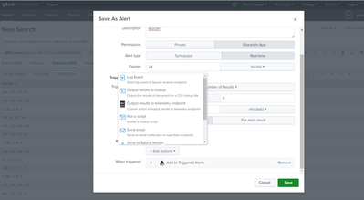

In Splunk you need to configure alert actions, as you can see many come out of the box for your use case, you have a few options that you can explore.
1. Use this Add-on - it may help with some config/testing so needs to be installed - https://splunkbase.splunk.com/app/5520
2. Develop your own Action - https://dev.splunk.com/enterprise/docs/devtools/customalertactions/
