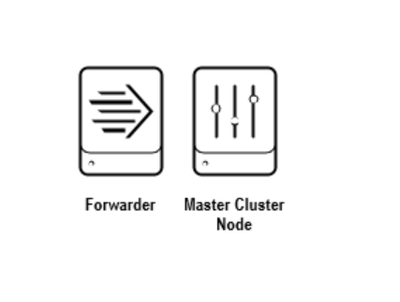

That worked fine for me. Went on the Design tab, and selected no Theme and now they look like in the picture below. Thanks!

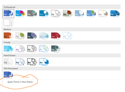

Same issue here. But if I click on 'Remove Theme" up in the Shape Styles editing box, the blue disappears. BUT...I'm still stuck the a label I cannot relocate, edit or delete. Damn you, Microsoft!!
hawkdogg01
New Member
uncheck this.
