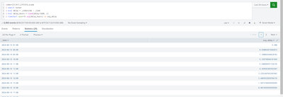

@PickleRick As per the below screenshot I can see huge delays in the indexing. So is this the cause that data is not visible on time.
What actions I need to perform for summary index?

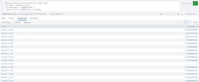

I ran query for on the source data which fills the summary index and below is the results.
ITWhisperer
So this is the reason why you are missing summary data. There could be a number of reasons for this difference.
  • It could be that there is a delay in your infrastructure such that it takes a long time between the event being written to the log which is being ingested
  • It could be that the application is writing events with an event time which is many hours prior to the time it is written to the log
You should investigate this. If this is not something that can be fixed, then you could look at your summary index population searches to take these delays into account e.g. running "back fill" search that populate your summary index with these "delayed" events. You would need to be careful about "double-counting" events which have already been included in earlier populations of the summary index
