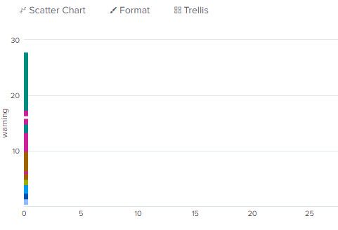

But if I try to display this table as a scatter plot via Visualization I got a strange plot:
It looks like the scatter plot can not handle the interval information.
ITWhisperer
index="..." sourcetype="..."
| strcat opc "_" frame_num "_" elem_id uniqueID
| search status_1="DRW 1*"
| bin _time span=20m as interval
``` scatter plot will need a numeric ```
| eval interval = tonumber(strftime(interval,"%H%M"))
| stats count as warning by interval, uniqueID
| table uniqueID interval warning
