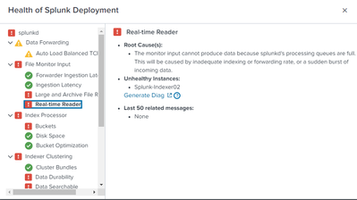

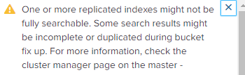

Hello Members,
i have problems between the peers and managing node (CM), I tried to identify the issue but i canno't find a possible way to fix it because i didn't notice any problems regarding the connectivity
see the pic below

how can i solve it the disk volume high but how can i ensure the data can be aligned is there commands or something to check ?
gcusello
Hi @KhalidAlharthi ,
when you'll give sufficient disk space, indexers should be automatically aligned, even if some time will be required.
You could check the replication status, after some time from the Cluster Master.
Cluster Master gives you the feature to force rebalancing.
the indexing queue is full, probably because you don't have enough disk space or there are too data for the resources Indexers have.
