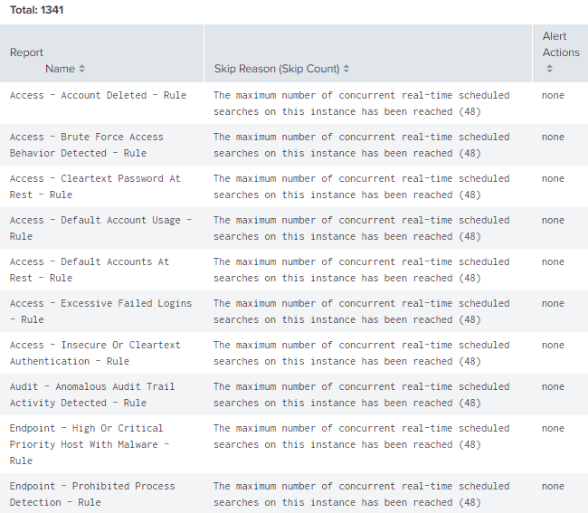

Starting from the position of a person who presents an error message, it is normal for them to manifest the error that appears.
"The percentage of non high priority searches delayed (81%) over the last 24 hours is very high and exceeded the red thresholds (20%) on this Splunk instance. Total Searches that were part of this percentage=81. Total delayed Searches=66"
I have not activated anything other than the correlation events and queries that splunk enterprise security brings by default, I just set them from inactive to active.

Start with the Monitoring Console.  Select Search->Scheduler Activity: Instance then scroll down to the "Count of Skipped Reports by Name and Reason" panel.  This will list the most commonly skipped searches.
Take a look at the "Count of Skipped Reports Over Time" graph.  It will show the time of day when searches are skipped.  Make note of the high and low periods so you can change schedules from peak times to non-peak times.

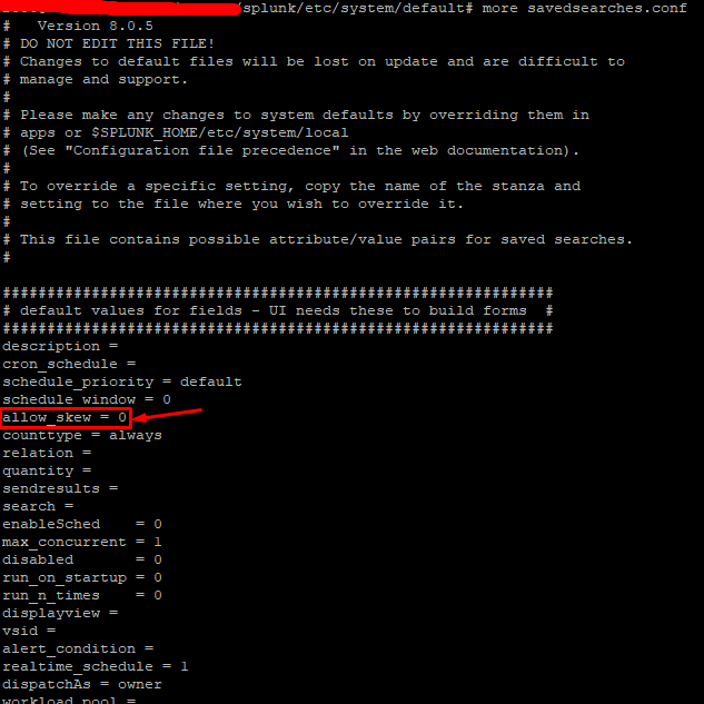

Hi @splunkcol , you can also use allow_skew feature to help in this situation - searches which are not high priority can be skewed to avoid impacting the schedule of high priority searches.
We also faced the high skipped and continued searches issue and allow_skew worked like a charm. Please read the details on what it does and hot it works to understand if this is something which can help you further.
https://docs.splunk.com/Documentation/Splunk/8.0.5/Report/Skewscheduledreportstarttimes

@Nisha18789 I see that by default it is in this way
/splunk/etc/system/default
Now I must go to /splunk/etc/system/default and create a file called savedsearches.conf
allow_skew = 50%
Is this value correct or what do you recommend?
Nisha18789
Builder
hi @splunkcol , sorry for the delay in response.
Regarding the allow_skew value, please be careful, as any value you assign inside system/default will be applied globally and impact all your searches.
For ex- if you set allow_skew=50%, and if there is  search which runs every 5 mins, after allow skew it will run  any time between 5 +2.5(50% of schedule interval)=7 mins. ---> which might be acceptable
And if a search is running every 24 hours , it can run anywhere between 24+12=32 hours --> which should not be acceptable.
What I am trying to say by this information is that , you should first start with allow_skew on a bunch of searches and see the behaviour to get an idea on how the scheduling changes for those searches. Once you are confident, and  you want to implement this globally, you might want to start with a lower value of allow_skew like 5% and monitor your searches and increase/decrease this value based on your findings.
Allow skew is a very good feature but needs to ve used with caution to avoid any delays on searches which are time sensitive and delays  in alerting of which are not acceptable by your business.
Hope this helps, let me know if you have any questions.
