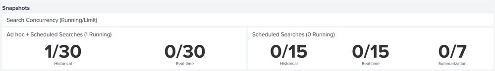

As per the below Screenshot:
  1. Convert real-time searches into scheduled searches.
    is real time = Ad-hoc?
    Could you please assist in differentiate the difference between the (Historical - Realtime - Summarization - Ad-hoc) Searches?

The screenshot shows the system to be nearly idle and must have been taken when the health indicator was green (or is about to turn green - it can take up to 24 hours for the health indicator to reset).
