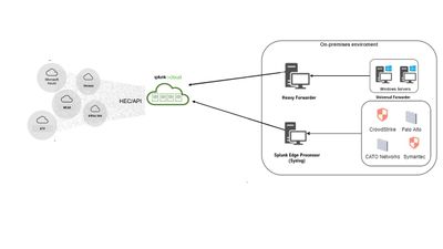

Hello,
I have a problem because I can't see the windows logs in splunk cloud.
My architecture is as follows: UF->HF->Splunk cloud
I get the logs on the HF because I see them by doing packet inspection with tcpdump. So I have 9997 open, but these are not being forwarded to the cloud.
