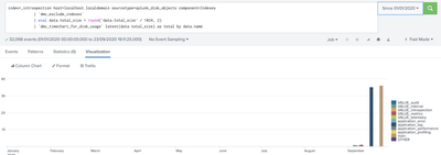

anujarosha
I think I found the query that I need.
You have to run this in Splunk monitoring console search (Ex. http://your-splunk-server:port/en-GB/app/splunk_monitoring_console/search) not the default search (Ex. http://your-splunk-server:port/en-GB/app/search/search )
index=_introspection host=localhost.localdomain sourcetype=splunk_disk_objects component=Indexes
            | `dmc_exclude_indexes`
            | eval data.total_size = round('data.total_size' / 1024, 2)
            | `dmc_timechart_for_disk_usage` latest(data.total_size) as total by data.name
Which gives output like below which is I needed.

isoutamo
Good, and with Ctrl+E (windows) or Cmd+E (macOS) you could expand those macros and easily modify those if needed.
Other good shortcut is Ctrl+F / Cmd+F which auto format command line.

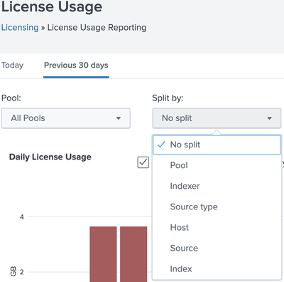

anujarosha
@inventsekar we are using Splunk version 8.0.1. As I read, DMC now called as Monitoring Console
In that case we are using DMC or the Monitoring Console. But when I go inside that I don't have any data for Disk Usage
Under the License Usage I can see the Split option that you have mentioned. But that is not my current requirement.
What I need is to get an understanding how much disk space (physical hard drive) has been filled per month for the last year because of the data that we are feeding to the Splunk.

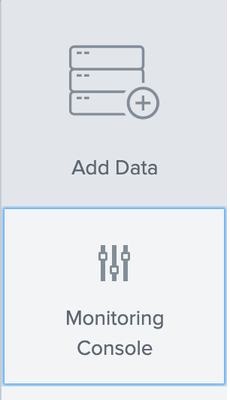

isoutamo
Hi
Do you have single instance or distributed environment?
If single then just go to settings -> select single -> check and edit server roles if needed and apply settings. After that MC (Monitoring Console, current name of DMC) is usable and those reports should work.
If you have distributed environment then you must read how and where you could and should install and configure MC. See https://docs.splunk.com/Documentation/Splunk/8.0.6/DMC/DMCprerequisites
DON't install it another nodes as described in the above doc!
