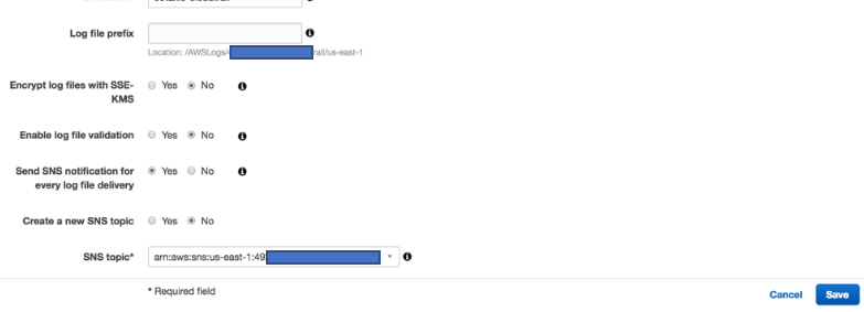

Expected process by Splunk Add-on for AWS is as below:
1. Enable/configure cloud trail logs to s3 bucket and enable SNS topic
2. create standard SQS queue ( This queue will be used as Dead Letter queue in SQS queue creation of 3rd step)
3. Create standard SQS queue with below configuration
Make sure your SQS queues have same configuration as below (except name, because your SQS will have different name)
DLQ Configuration for SQS created in step 3 : Choose queue created in 2 step.
after creating the queue from step 3 . open queue created from step 3 and subscribe to SNS topic

You need to follow the second option.
2> aws cloudtrail/config > S3 bucket > Event notification trigger as SNS > SQS subscription > Splunk
Enable the cloudtrail sending notification to SNS
Create SQS and subscribe the SNS to it
In splunk, create the cloudtrail input and choose the SQS that was created in the last step.
