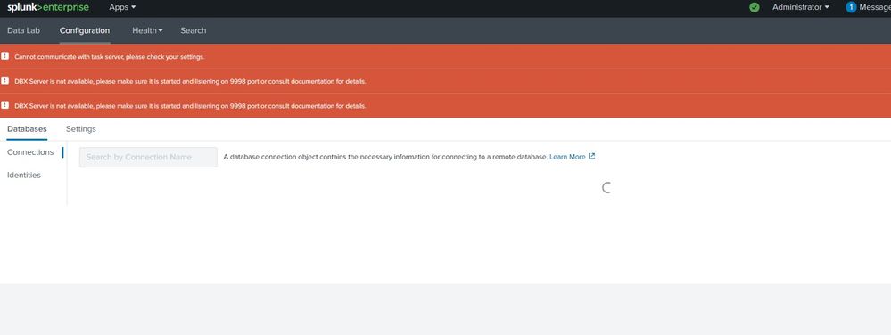

I installed DB Connect on Heavy Forwarder but I get message the task server cannot start. Eariler I installed DB Connect of Search Head (the same way) and it worked fine. What is the problem with Heavy Forwarder?

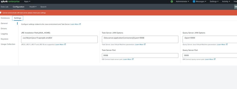

Installs DB Connect on a heavy forwarder the same way it is installed on a search head.  Make sure the HF has the right Java and JDBC drivers installed.  If it still doesn't work, please share the exact error message text.

I did it many times od Search Head and it always worked. I did it exactly the same way on HF and it does not work. I checked path to Java, I restarted Splunk several times and I still get this error message 😞
