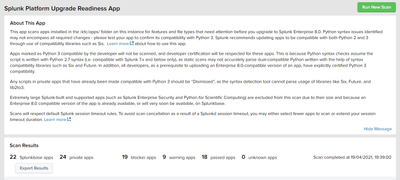

rahul2gupta
Hi @gcusello ,
We installed an app "Splunk Platform Upgrade Readiness App" and scanned all the apps in our existing environment.
It shows the following output.
Query: What is blocker apps and what should be our next step?
Regards,
Rahul Gupta
isoutamo
Hi
Blocker apps are something what you must fix before update. You should see those on that report and also this report should show you some hints what is wrong with those and how to fix those.
Here is one other good link to update order of distributed environment https://community.splunk.com/t5/Installation/What-s-the-order-of-operations-for-upgrading-Splunk-Ent.... Unfortunately they haven't added to use of that readiness app here.
r. Ismo
