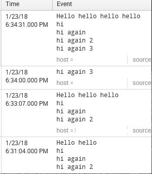

Hi - See the attachment I have uploaded
I started with the text at 6:31 (source is a simple .txt file continuously monitored)
@ 6:31
Hello hello
hi
hi again
hi again 2
Now, at 6:33 , I just added anextra hello to line 1 in the .txt file
but see the event being indexed at 6:33 . Splunk indexed ALL the lines again, even though I did not change anything in lines 2,3&4 in the .txt file......
Hello hello hello
hi
hi again
hi again 2
Now again at 6:34 I added a new line to the file hello again 3, this time Splunk indexed ONLY the new line and NOT ALL the lines in the text file.
Now again, at 6:34:31 I added another hello to line 1 , Splunk indexed ALL the lines again from the text file.
See the behavior?
So - Without knowing your file structure , it is difficult to say why the continuous monitoring is affecting your license, but trust me it does. I have seen this behavior before.
