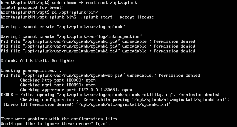

This is what I'm getting now:
CLI

When using --accept-license, i receive two more warnings unfortunately:
Warning: cannot create "opt/splunk/var/log/splunk"
Warning: cannot create "opt/splunk/var/log/introspection"
Warning: cannot create "opt/splunk/etc/licenses/download-trial"
