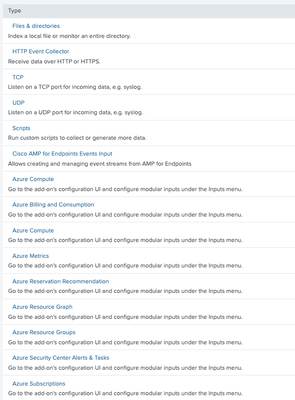

Upon installing the Akamai SIEM I am not seeing the data input option for "Akamai​ Security Incident Event Manager API", please advise?  Java is installed and running Splunk 9.3.3

cmutt78_2
Not there and no additional pages to navigate

cmutt78_2
yep, I am thinking it is an app issue
