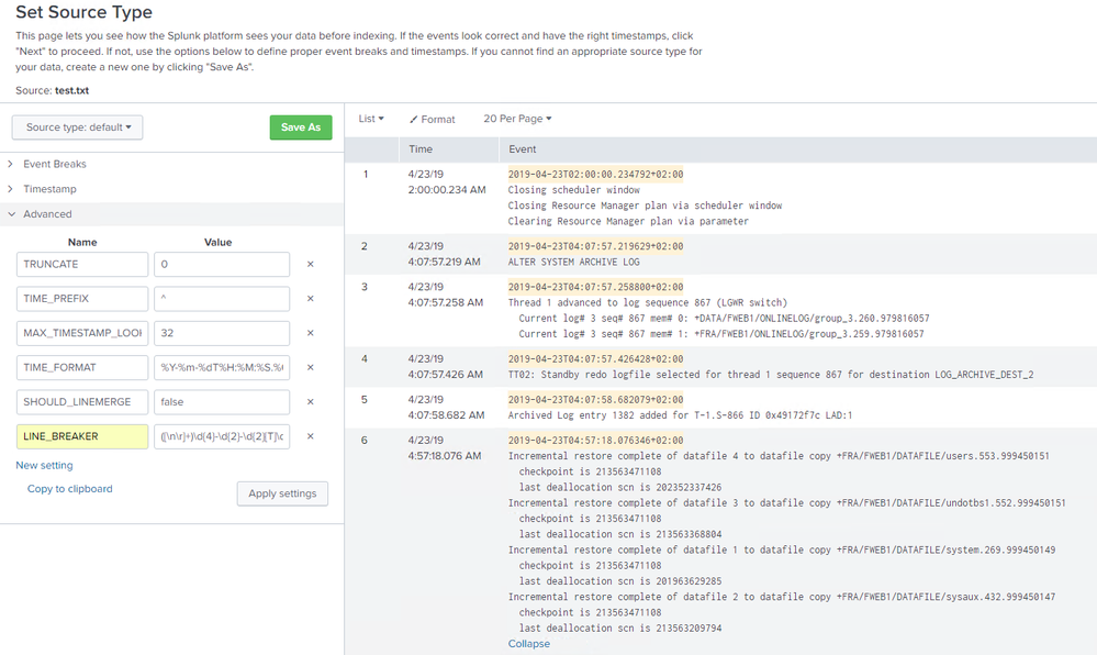

I am currently having some problems breaking certain events from an Oracle log correctly. The log is being onboarded via a HF, and so the props.conf file containing the sourcetype of the log is located there. This is my current props.conf configuration for the sourcetype:
[application:env:oracle:alert]
TRUNCATE = 0
TIME_PREFIX = ^
MAX_TIMESTAMP_LOOKAHEAD = 32
TIME_FORMAT = %Y-%m-%dT%H:%M:%S.%6Q%:z
SHOULD_LINEMERGE = false
LINE_BREAKER = ([\n\r]+)\d{4}-\d{2}-\d{2}[T]\d{2}:\d{2}:\d{2}.\d{6}\+\d{2}:\d{2}
A sample of the log file:

How it is being parsed in "Add Data" preview on the HF:
How it is being parsed when "live" (host, source and sourcetype have been anonymized):
As you can see the last log message is not being parsed correctly according to the props.conf specifications. Any ideas on how to fix this so that the log is onboarded correctly?
