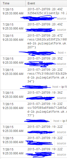

alt textSplunk n00b here.
Our Splunk system was recently indexing the wrong timestamp. I made some alterations to props.conf and now I get thousands of logs indexed at the same time even though the time within the actual logs (ie the timestamp in the log itself rather than the Splunk timestamp) are completely different.

The problem is that Splunk cannot find a timestamp (because you are not correctly telling it how to do so) so it is defaulting to the last timestamp it has from this sourcetype. You will find error logs that say something like "cannot identify timestamp; defaulting to timestamp of previous event".
There is a scoping problem in that you are using a [default] stanza instead of one specifically targeted to your events so let's fix that first. I assume this means that you are editing $SPLUNK_HOME/etc/system/local/props.conf which is an exceedingly poor decision for many reasons. Pick a name for your thing like MyApp and create a directory structure like this $SPLUNK_HOME/etc/apps/MyApp/default. Inside this, create a props.conf file with these settings (instead of myAppSourcetype, use whatever you specified in sourcetype= inside of your inputs.conf file, which should also be moved into the same `MyApp directory structure (but on the Forwarders instead of the Indexers):
