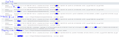

If i search for the host from the fortigate input the following shows up, which to me looks like it should be forwarding logs?

I am recieving internal logs from the syslog server.
I am recieving other logs( for example the cisco logs) from the syslog server
I am NOT recieving logs from the fortigate input from the syslog server (Deployed with the same app as the cisco input)
The user running splunk is root on the syslog server
I am ecen seeing both inputs correctly here on the deployment server
Am i reading these entires correct in that it IS in fact transmitting data from the fortigate input?
