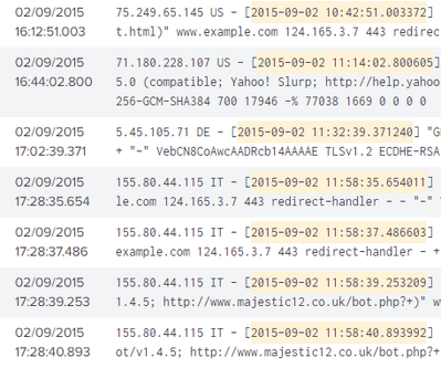

hi,
Please check with below screenshot
The indexed time and event log time both are different. Kindly let me know the solution to fix this error.

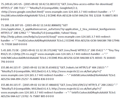

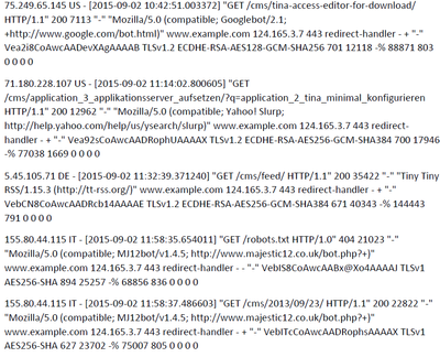

Atchyuth_P
Hi @gcusello
Please check the below screenshot for reference.
I have applied the MAX_DAYS_AGO setting in Splunk it identified the Y-m-d but was unable to find out the exact hours, minutes, seconds
I have tried with the TZ setting but was unable to solve it.
Please help

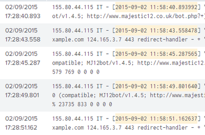

Atchyuth_P
Hi @chaker
Thank you so much. I have learned a lot about Splunk while watching your videos and those helped me to shift my career transition.
Please help
