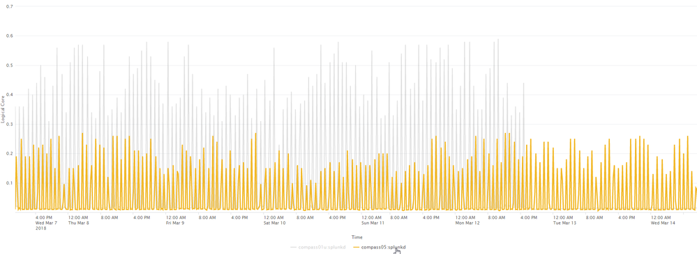

I have over 150+ UF and they all behave the same. splunkd CPU usage is about 5% but every hour it spikes, up to 50-60%. This has been going on for many months. I have AIX and Linux UF and they all behave the same.
If I do a fresh install, it doesn't do that. But over time, the spike starts to happen. Recently, to test, I upgraded two AIX UF from version 6.5.2 to 7.0.2.
On one, I wiped out the entire install folder, basically started from scratch. There is no more spike on this one (but only a matter of time before it does it again).
On another, I simply upgraded over the existing install. The spike remained the same.
Something in splunkd is using more CPU over time, every hour. I would like to know what it is so I can possibly disable/play with it. splunkd CPU usage on my servers needs to be as low as possible.
Are people using UF on AIX and Linux seeing this too?
Below: UF that I wiped clean before reinstalling. We can see the spikes stoping after fresh install.
Below: UF that I simply upgraded. Spikes remains.

You are likely seeing a spike in I/O and CPU from the fishbucket snapshot every hour, can you check $SPLUNK_HOME/var/lib/splunk/_fishbucket , in particular I believe it's the directory:
$SPLUNK_HOME/var/lib/splunk/_fishbucket/splunk_private_db/snapshot
That you should see the timestamp on changing every hour, see it if matches the timing of the spikes.

Yes! Finally some hint of what's going on! Now more questions:
What exactly is it doing and anyway I can stop it or change some settings or something?
