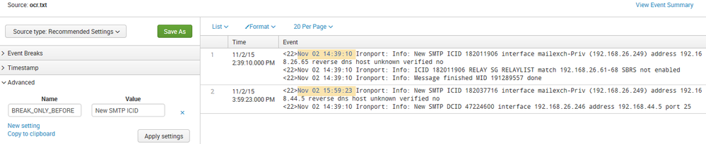

martin_mueller
Unrelated to the actual question: Splunk 5 is quite old, consider upgrading to 6.3 - many great things await.
The props.conf setting you're looking for should be BREAK_ONLY_BEFORE = New SMTP ICID.

secuc2r83
Hi Martin,
The problem is solved by your last sentence.
I was sure that when you restart, it always reindex....
(Then all my props's change never be applied because restart splunk didn't reindex!)
I just change my log file and launch a search to see the same result as yours.
Thanks a lot for your time Martin
Regards
martin_mueller
It'd be terrible if Splunk reindexed Petabytes of data every restart for some of the larger installs...
martin_mueller
Setting only BREAK_ONLY_BEFORE = New SMTP ICID seems to work fine for me:
Make sure you configure this on the correct machine (any heavy forwarder involved?), there's no other configuration involved (props.conf on the source::, host::?), and you actually reindex that data after the restart.
