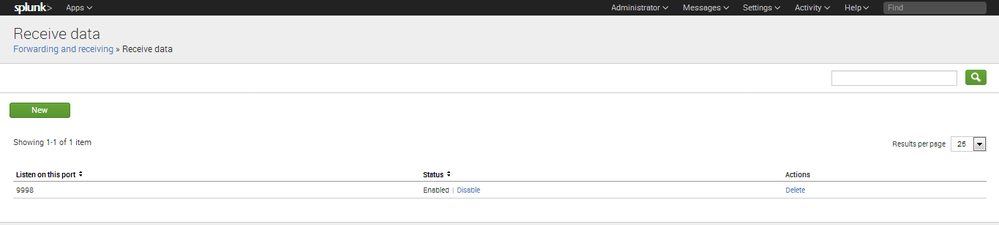

Open port 9998 to receive events (set up at http://localhost:8000/en-US/manager/search/data/inputs/tcp/cooked)

hardikJsheth
Motivator
What you need to do is enable receiving on your guest 1. For login to Guest 1 splunk web ui, go to Settings --> Forwarding And Receiving and configure receiving.
On Guest 2 where you have installed universal forwarder, add outputs.conf entry to enable UF to forward data to Splunk Enterprise server.
[tcpout:eis_clustered_indexers]
server = ip_address:port
