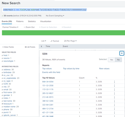

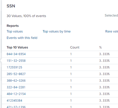

If I run this:
index=main | rex field=_raw mode=sed "s/(\D)\d{3}-?\d{2}-?\d{4}(\D)/\1XXXXXXXXX\2/g"
I get all of the results back, but the SSN's are still in clear text (not redacted)
