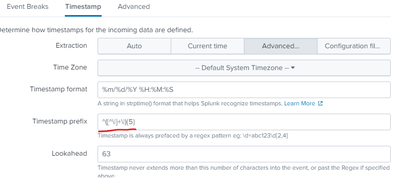

I have the data has "1111|xxx, xxx y|000000|111111|firstname, lastname|10/13/22 02:12:09|"
I used TIME_FORMAT = %m/%d/%Y %H:%M:%S
and Timestamp prefix = ^(?:[^\|\n]*\|){5}
However, I still get an error stating could not use strptime to parse the timestamp.
Would need help in providing timestamp prefix here.

TIME_PREFIX = ^([^|]*|){5}
And you need %y instead of %Y (you don't have full year number, just two last digits)

gcusello
Hi @poojithavasanth,
please try this:
TIME_PREFIX = ^([^\|]+\|){5}
Ciao.
Giuseppe
poojithavasanth
Yes, it is TIME_PREFIX
