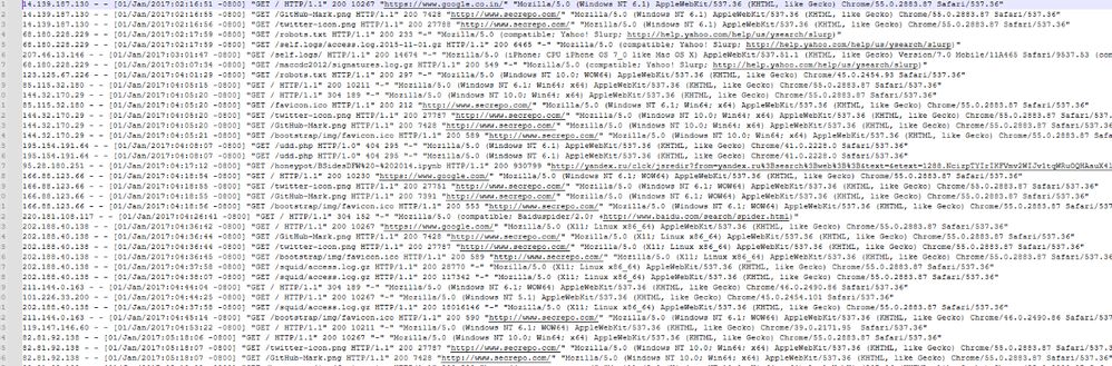

I’m having trouble getting Splunk to recognize timestamps correctly, and I hope someone can help me out. I’m importing an access log file, where the timestamps are formatted like this:
[01/Jan/2017:02:16:51 -0800]
here also a live output:
However, Splunk is not recognizing these timestamps and instead assigns the indexing time.

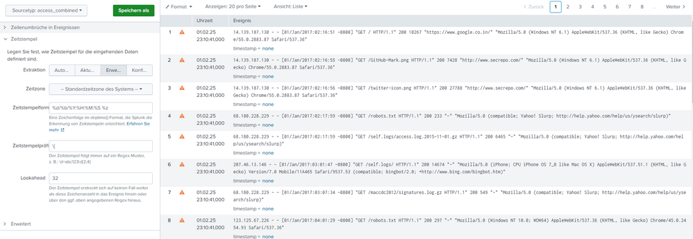

I have tried adjusting the settings in the sourcetype configuration (see screenshot) and have set the following values:
• Timestamp format: %d/%b/%Y:%H:%M:%S %z
• Timestamp prefix: \[
• Lookahead: 32
Unfortunately, the timestamps are still not recognized correctly.
👉 Do I need to modify props.conf or inputs.conf as well?
👉 Is my timestamp format correct, or should it be defined differently?
👉 Could there be another issue in my extraction settings?
The log file looks like this:

It looks like your time extraction settings are corrrect, however you need to add MAX_DAYS_AGO to be a higher value (eg 3000) for Splunk to accept that 2017 timestamp as the default is 2000 and therefore Splunk is not accepting the date.
Let me know if adding MAX_DAYS_AGO=3000 to your extraction config works!

Your suggestion to increase MAX_DAYS_AGO to 3000 completely solved my issue, and Splunk now correctly recognizes my timestamps.
