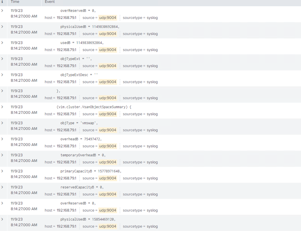

Yes what I do is do Data Inputs > TCP > New Local TCP > Port 9008 TCP / Source type = Syslog / Method = IP / App Context = search and reporting / Index = default.
If I switch, I delete the TCP and add in a new UDP with the same settings.
Right now I have a TCP 9008 and a UDP 9004 running, with the same appliance forwarding logs via Syslog to both TCP and UDP ports. TCP has been working fine for 4 days now (though with lots of dropped events). Appliance sends logs fine from appliance via UDP, but Splunk has stopped searching within 1 hour.
The same log appears as the last shown log. It is a memory output that breaks down over around 50 lines (assuming it is too big). Could there be some error occuring with a sylsog that is too big that is breaking searching?
The search I am using is source="udp:9004"

UDP. The picture is UDP. I am sendings logs via Syslog on port UDP:9004.
I only opened TCP:9008 for testing purposes. Everything works on TCP as expected.
I want to fix UDP.

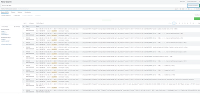

I switched the time from (past 5 minutes) to All Time (real time) and logs are appearing. There is an issue with how Splunk is processing Time from these logs it seems.

Timestamp correct. Timestamp received by Splunk matches what is recorded on the appliance.
All time (real-time) is the only search that allows me to see logs. Searching any other time does not work.
For example, look at pictures below.  Searching in previous 5 minutes shows no logs. I switch to All time (real-time) and all logs are being shown.
