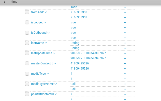

I never ran into this problem before, but I hope someone has..
I have a python script which calls a REST API and passes the JSON to Splunk via the HEC.
The fields are single-valued, however, Splunk converts them to multi-value.
Does anyone know why this is happening and how to fix it?

Set KV_MODE to NONE and it will go away. Actually a value of AUTO might be better but the real problem is that right now it is set to JSON which is wrong because then you are parsing the JSON twice. This is definitely the problem.

Do you have multiple extraction methods defined?
Such as using indexed_extractions and kv_mode?
fdarrigo
No I don't
jkat54
Can you provide a data sample and the sourcetype you’re using?
