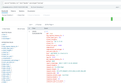

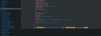

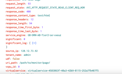

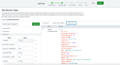

@splunklearner I tried this using your sample data; please have a look.
kiran_panchavat_1-1739098606746.pngkiran_panchavat_1-1739098606746.pngkiran_panchavat_2-1739098618659.pngkiran_panchavat_2-1739098618659.png
[syslogtest]
SHOULD_LINEMERGE=false
LINE_BREAKER=([\r\n]+)
NO_BINARY_CHECK=true
CHARSET=UTF-8
category=Custom
pulldown_type=true
SEDCMD-removeheader=s/^[^\{]*//g
KV_MODE=json
AUTO_KV_JSON=true
Did this help? If yes, please consider giving kudos, marking it as the solution, or commenting for clarification — your feedback keeps the community going!
