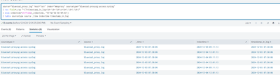

Splunk Search (Streaming data):
Splunk Search (uploaded data):
