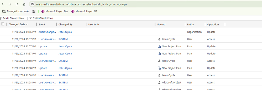

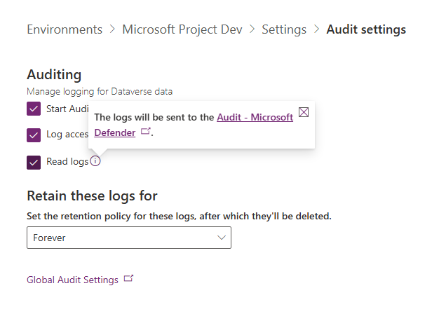

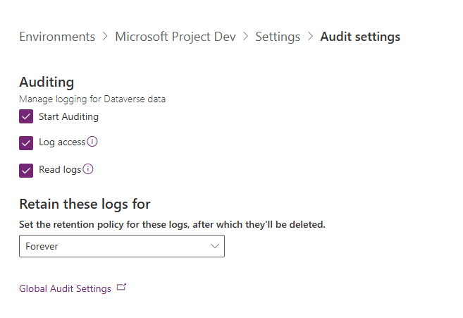

We are looking for Power Platform audit logs to ensure that these logs will automatically show up in SPLUNK if they are available in Purview.image (3).pngimage (3).pngimage (2).pngimage (2).pngimage (1).pngimage (1).pngimage.pngimage.png

Hey @bellb,
You'll need to install and configure inputs for Splunk Add-on for Office 365 (#4055) to be able to collect the data. I found one of the community links for power platform where a user was able to successfully integrate power platform with Splunk - https://community.powerplatform.com/forums/thread/details/?threadid=aa044430-445e-48dc-ab79-7f30abdc...
