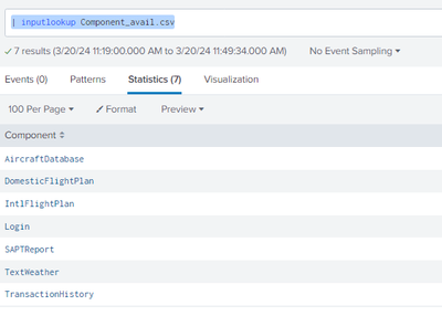

Alright maybe not enough coffee....I am going in circles trying to get this to display the values in the csv.  Cant figure out what needs to go with the fillnull value.
index=my_data data.environment.application="MY APP" data.environment.environment="test"
| eval estack="my_stack"
| fillnull value="prod" estack data.environment.stack
| where 'data.environment.stack'=estack
| streamstats window=1 current=False global=False values(data.result) AS nextResult BY data.componentId
| eval failureStart=if((nextResult="FAILURE" AND 'data.result'="SUCCESS"), "True", "False"), failureEnd=if((nextResult="SUCCESS" AND 'data.result'="FAILURE"), "True", "False")
| transaction data.componentId, data.environment.application, data.environment.stack startswith="failureStart=True" endswith="failureEnd=True" maxpause=15m
| stats sum(duration) as downtime by data.componentId
| inputlookup append=true Component_avail.csv
| fillnull
| addinfo
| eval uptime=(info_max_time - info_min_time)-downtime, avail=(uptime/(info_max_time - info_min_time))*100, downMins=round(downtime/60, 0)
| rename data.componentId AS Component, avail AS Availability
| table Component, Availability

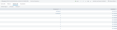

Ok I guess one last thing.  When the results for the report are 100% across the board.  I don't get any results it is blank.  There seems to be the need for a result below 100% to return all fields again.
PickleRick
A quick and ugly hack would be to run your original search (that one calculating availability) and then do
| append [ | inputlookup Component_avail.csv
    | eval Availability=100 ]
| stats min(Availability) as Availability by Component
Alternatively, you can define your lookup to contain both fields - Component and Availability (with Availability set to 100 across the board) and use
| inputlookup append=t Component_avail.csv
and then do the stats.
This way if your original search calculates some non-100% availability you'll get it in your final results. If there is no sub-100 availability calculated, you'll get the static 100 provided by the lookup.
