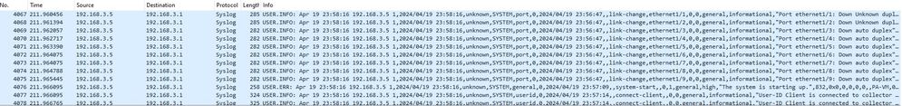

I have Splunk Installed on a windows machine and configured PaloAlto app along with Add on.
I have done configurations on Palo Alto. I can see from packet Capture that palo alto is sending logs successfully to the windows machine where splunk is installed but I cannot see anything in splunk itself. Can anyone help?

PickleRick
That dump looks pretty much OK.
Are you 100% sure your udp:514 input sends to the right index? You can also try to find reports about that particular source of syslog data with
index=_internal source=*metrics.log group=udpin_connections 192.168.3.5
If Splunk is receiving data from this host on that udp input, you should get some results with metrics field like _udp_bps,  _udp_eps and so on.

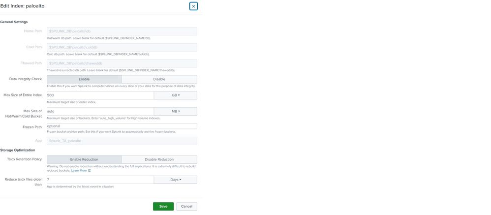

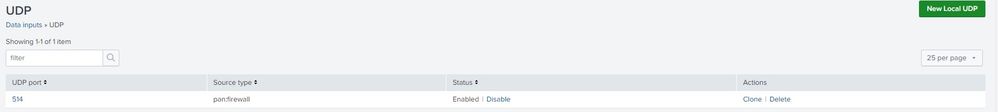

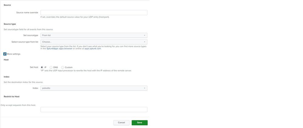

I tried to query "
It did not come back with anything.
I believeData Input.jpgSplunk Index Detail.jpg i have configured the data input correctly and pointing to right index
PickleRick
At first glance looks pretty OK.

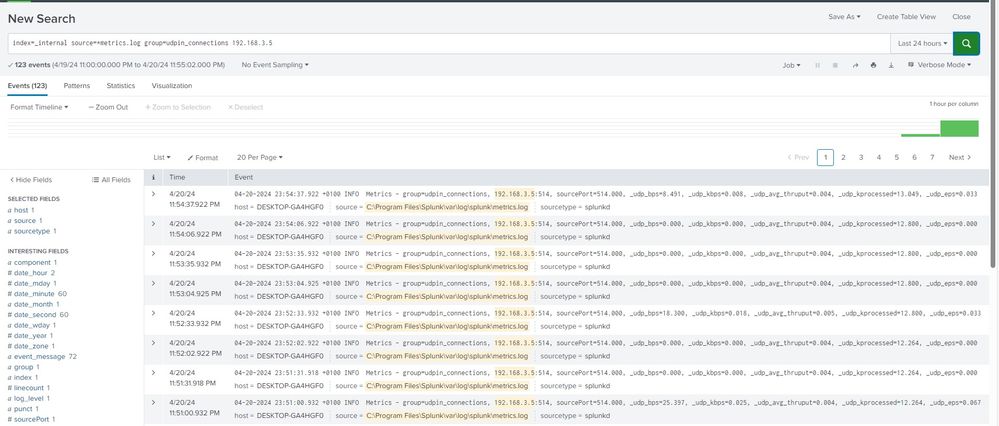

update: I have gone over the configs and
is giving following output.
PickleRick
We're getting somewhere 🙂
As you can see some non-zero values, it means that some data is indeed being received by the udp input. Now we need to find where it goes to.
By the fact that it's a windows installation and because it's called "DESKTOP-something" I assume that it's your private test box and you're not having a lot of data on it. So you can run a
index=*
search over "All time (real-time)" - this is one of the very very rare cases where real-time search makes sanes. Very important - don't try this on any production or heavily loaded test box.
With this you can see the events as they come into your Splunk box (so if your events are rare you might to wait a while). Check the index, source, sourcetype and timestamp of the incoming events.

Hello PickleRick,
I he created data input o allow udp14 traffic. So is index. Please check these screenshots for clarity,
192.168.3.5 is Palo Device and 192.168.3.1 is windows machine where Palo Syslog capture.jpgSplunk Index.jpgSplunk Input.jpgSplunk is installed
