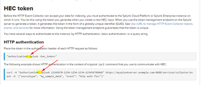

According to my tests the Authorization header should not have a space between the colon and splunk keyword.  It should be "Authorization:Splunk ###-####..." and not "Authorization:  Splunk ###-####..."
https://docs.splunk.com/Documentation/Splunk/9.0.1/Data/FormateventsforHTTPEventCollector
In other words this works:
curl -k https://prd-p.splunkcloud.com:8088/services/collector -H "Authorization:Splunk ###-######" -d "{\"sourcetype\":\"_json\",\"index\": \"job1\",\"event\": {\"a\": \"value1\", \"b\": [\"value1\", \"value1\"]}}"
Whereas this does not work:
curl -k https://prd-p.splunkcloud.com:8088/services/collector -H "Authorization: Splunk ###-######-b680-72c7bd33f9bb" -d "{\"sourcetype\":\"_json\",\"index\": \"job1\",\"event\": {\"a\": \"value1\", \"b\": [\"value1\", \"value1\"]}}"

-H "Authorization: Splunk eae66351-aaaa-1111-2222-2787781f501f"
works as documentation said. Actually you can use it with or without that space between : and Splunk.
What I have earlier seen, is that in some OS (like windows) and/or some shell configurations will generate some confusion with sending event with curl to HEC. Especially when you are surrounding event with " instead of '. In this first case you must do some escape for " on json field names and values and there are situation when this can leads to unwanted situation.
r. Ismo
