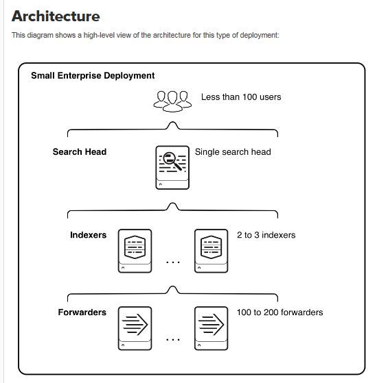

ddrillic
Ultra Champion
The Small enterprise deployment: Single search head with multiple indexers describes a close enough scenario.
It shows -
In one of the original courses, they show a transition from one Splunk server to the original one as the Indexer and a new one as a SH. So, what you are trying to do is legitimate ; -)
