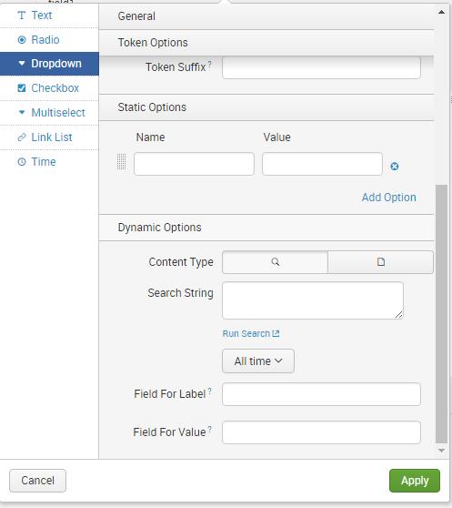

I am sure you could use javascript to accomplish this, but I would like to propose an alternative approach using Splunks integrated features(why re-invent the wheel, right?).
For automatically updating dropdown options I would recommend using "Dynamic Options" integrated in Splunk's dropdown menus. Here you could specify a search to get your newest ingested CSV-files data. Lets say you import it around midnight every 24h, a "Last 24hour" search window would probably suffice.
Dynamic Options - Search string to populate the dropdown options
The dynamic options could then again be used to feed data to your charts(using tokens), thus effectively making you able to change your graphs on the fly - all without javascript.
