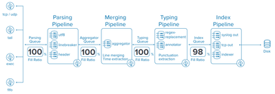

I've directed all universal forwarders to send to the intermediate forwarder, but the main indexer's still showing saturated queues. Local monitoring is limited to Splunk's own logs. Is there a way I can view what exactly is going into these queues, so I know where to chase the problem?

 The  default queue in inputs.conf was set to  IndexQueue?   So all your inputs by default, unless specified otherwise will SKIP parsing queues on HF.  That would not solve your problem of parsing queue getting full issue on your indexers.
so perhaps you need to remove that setting, but explicitly set queue=IndexQueue on sourcetypes that do not require scrubbing etc.
