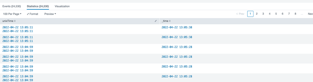

I have events where there is a unixTime field. But the _time field does not show correctly
how can I write in props.conf so that the _time field takes time from the unixTime field

@gcuselloHi!
as you can see, my _time field is ahead of the unixTime field. And I would need the _time field to be the same as unixTime
i want to change my sourcetype in props.conf so that _time takes time from unixTime field

Hi
can you add some raw data inside </> block?
Some resources to use when you are onboarding data:
Basically you should configure props.conf so, that it take correct field/place from event and recognise timestamps correct. See those TIME_*  and MAX_TIMESTAMP* for found correct place. Also LINE_BREAKER needs time by time some changes.
