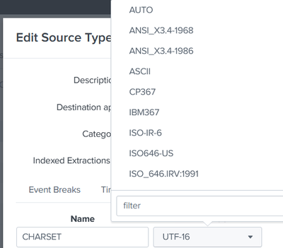

Hi
I suppose that your source file contains UTF16-LE characters? If so you must add encoding information to props.conf on HF side.
Here is couple of old answers which clarify this quite well
r. Ismo
pm2012
thanks @isoutamo
Just last doubt, how to check which format is it and which is supposed to be like UTF-18 or something else
isoutamo
You can use command file in linux see: https://www.shellhacks.com/linux-check-change-file-encoding/
Usually Splunk wants to use UTF-8 encoding.
