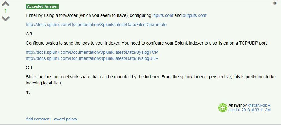

A similar discussion at How to get remote linux log into splunk
It says -
