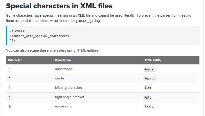

XML is amazingly simple in its specifications. It defined just five entity references for five characters and double quote is one of them.
Maybe you should you use the entity reference for the double quote.
Splunk explains at Special characters in XML files
It says -
msboers
Engager
Thank you for your comment ddrillic, this would still require me to edit the message and escape these special characters right? That would be the same problem I had with my second solution.
